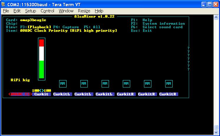

Attached is the output of Alsa mixer
---------------------------- Dmesg output -------------------------------------
[ 2.116241] asoc: twl4030 <-> omap-mcbsp-dai-0 mapping ok
[ 2.125885] ALSA device list:
[ 2.128906] #0: omap3beagle (twl4030)
Don't forget to use the arrow keys to cycle through the various mixer
levels. R/L chooses the mixer while U/D change the setting. The
particular settings for the headphone output on BB are the three for
DAC2 which are somewhat to the right of the one you show in your
screen capture.
Eric
Yes, have checked all the settings of DAC. Have put everything to maximum. Still no luck.
