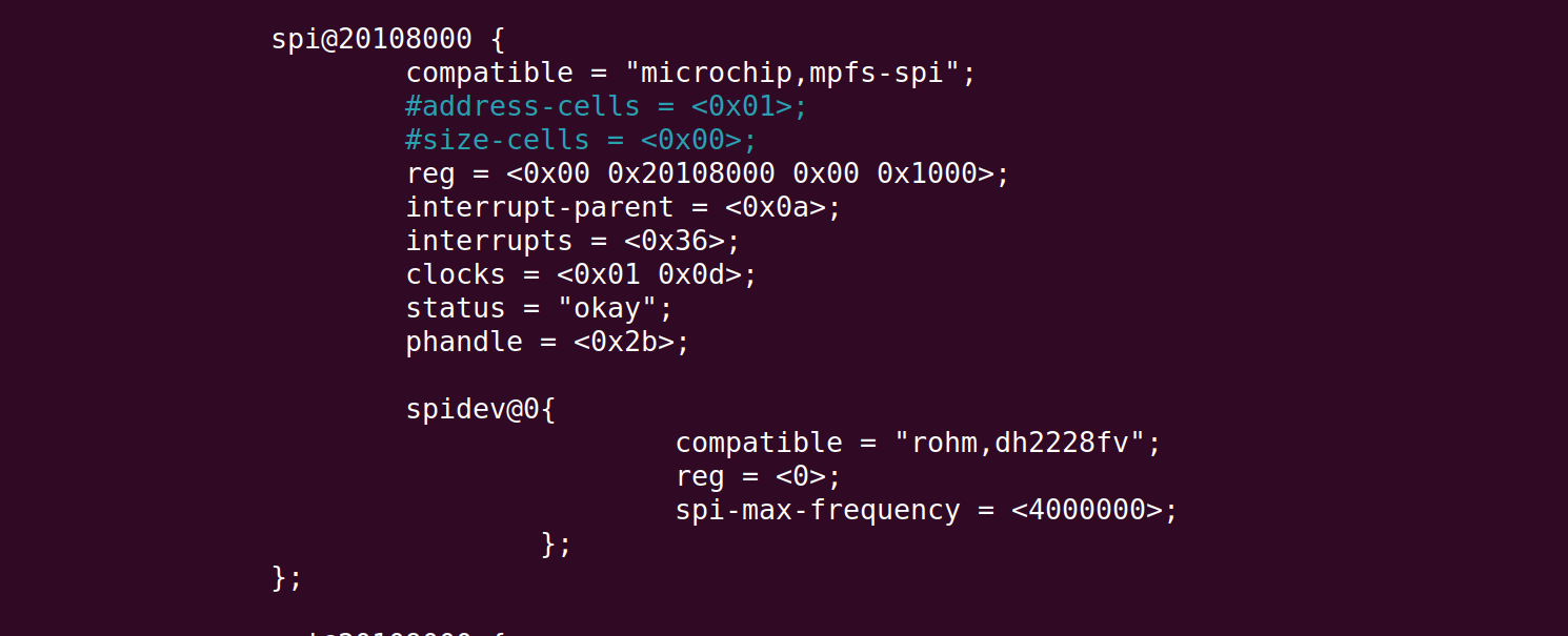

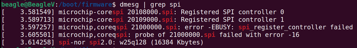

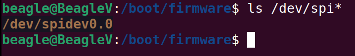

Hello Community. Trying to workout SPI connection between Beagle and the ESP32 using SPI0. I have managed to expose the spidev0.0 using this guide: beagle.md · GitHub However i am unable to make any communication to esp32. dmesg logs show that the SPI0 is enabled. What could be the problem?

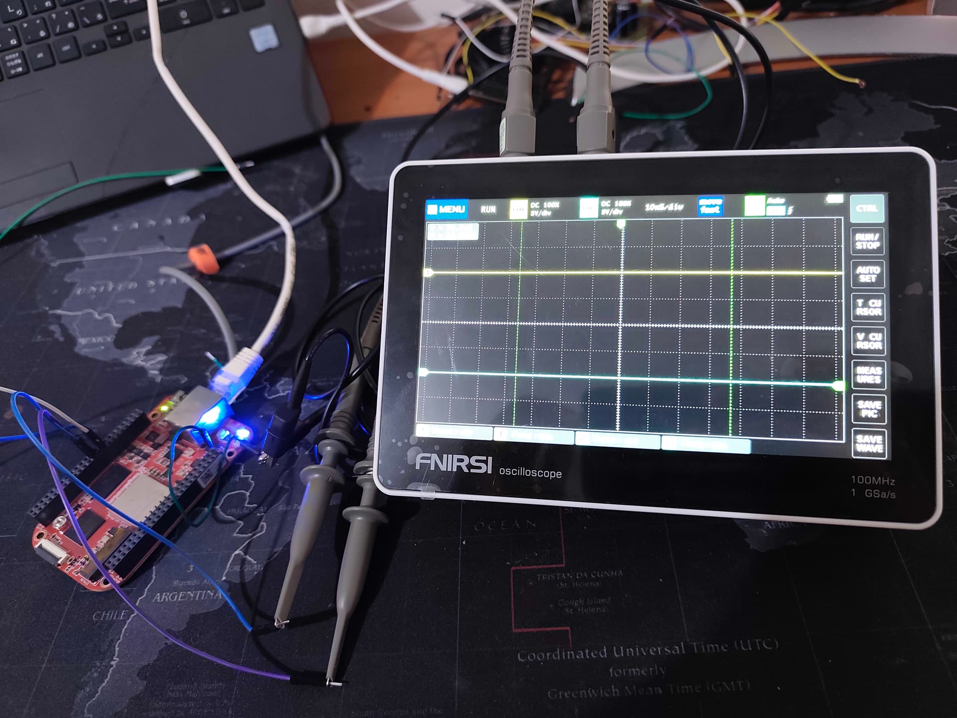

How exactly are you testing?
Have you hooked up a Scope or digital probe to the pins in question,
to see if you get any twiddles when you “test” ?
Also, please make sure your current Gateware is connected where you think it is…

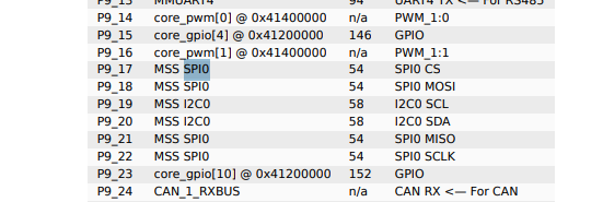

@lranders I am using an oscilloscope to monitor the SPI pins. I am not getting any twiddles while testing. I am using the Default Gateware. The SPI0 pins i am connected to are from the datasheet:
I guess I’ll ask again:
How exactly are you “testing” this?
Describe your test method.
Also, are you just looking at CS or are you checking SCLK and MOSI too?
