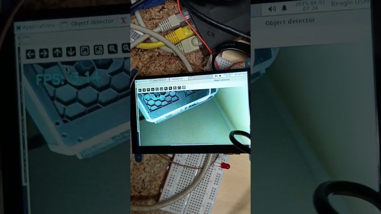

Step #4 on Demos for the BeagleY-AI under header tensorflow_lite
Is anyone coming across with this file not being available any longer?
pip install https://github.com/google-coral/pycoral/releases/download/v2.0.0/tflite_runtime-2.5.0.post1-cp39-cp39-linux_aarch64.whl
For whatever reason, I am getting a 404.
I am in Demos under the BeagleY-AI located here: TensorFlow Lite Object Detection — BeagleBoard Documentation
Whelp…I stand corrected. I can download the file but not use pip3 to install it. Off to try another route.
it works!
what camera and display panel do you use?
I have an older model USB Camera from Microsoft. I cannot remember the model name.
The panel is listed below… Off to search for the content of the purchase:
Amazon.com: Hosyond 5 Inch IPS LCD Touch Screen Display Panel 800×480 Capacitive Screen HDMI Monitor for Raspberry Pi 5/4/3, BB Black, Windows 10 8 7 : Electronics is the brand and it was purchased on Amazon in 2023.
