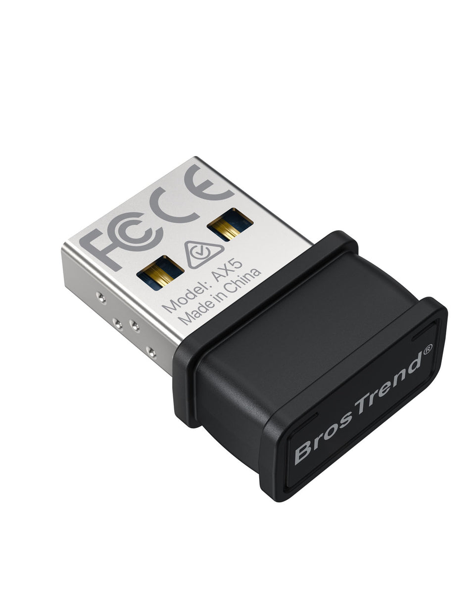

I’m new to the PocketBeagle, embedded linux and linux admin so I’m quite pleased that I got this working this evening. I’m happy to document it if there is a suitable place to do so. The PB is running the latest IOT distribution.
It’s a BrosTrend AC300 WiFi 6 2.4GHz device (called AX5L in their drivers) which I bought in the UK. It advertises wide Linux compatibility including older Raspberry PIs so thought it worth a shot. I had to manually install the linux headers and dkms prior to running their install script. Their script was failing until I did this. It uses the OpenIPC / aic8800 driver.
Having configured the wpa_supplicant config file I then installed usb-modeswitch and configured the rules at startup to auto switch the device from mass storage mode to wifi mode.
