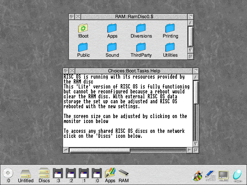

So you have your Beagleboard XM and have tried Linux. Why not try out
RISC OS?
It is very simple to do. You need to put two files onto the primary
partition of the micro SD card which will cayse RISC OS to be started
rather than Linux and you need to put three files onto a pendrive
(which is no more than 2Gbytes in size).
Plug the pendrive into one of the four USB sockets and make sure a
keyboard and mouse are also plugged in. Then reset the Beagleboard XM.
At the prompt type 'Exec RunMe' and RISC OS will start.
