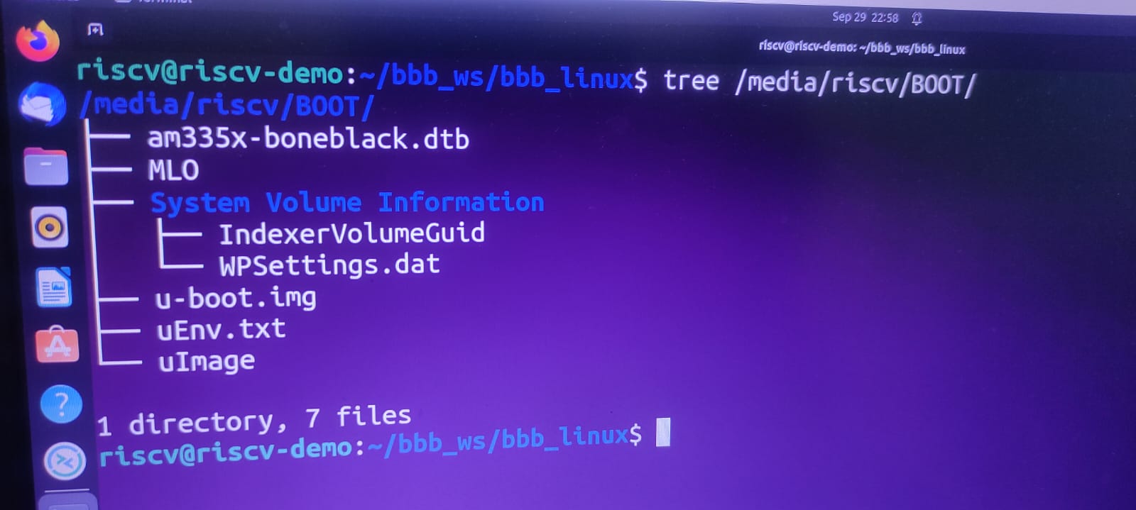

Now are you using? 1 or 2 partitions, what files are in /boot/*
(i assume MLO, u-boot.img, uEnv.txt, uImage and am335x_beaglebone.dtb but please state it…)
extra points for running, tree on your mounted boot location…
tree /<mounted>/boot
Hi Robert,
I have 2 partition of my SD Card(16 GB). 1st partition as BOOT(type: FAT32, Flag: boot & lba) and 2nd one Rootfs(type: ext4).
1st partition i.e BOOT has all files as mentioned MLO, u-boot.img, uEnv.txt, uImage and am335x_beaglebone.dtb . I have attached picture also.

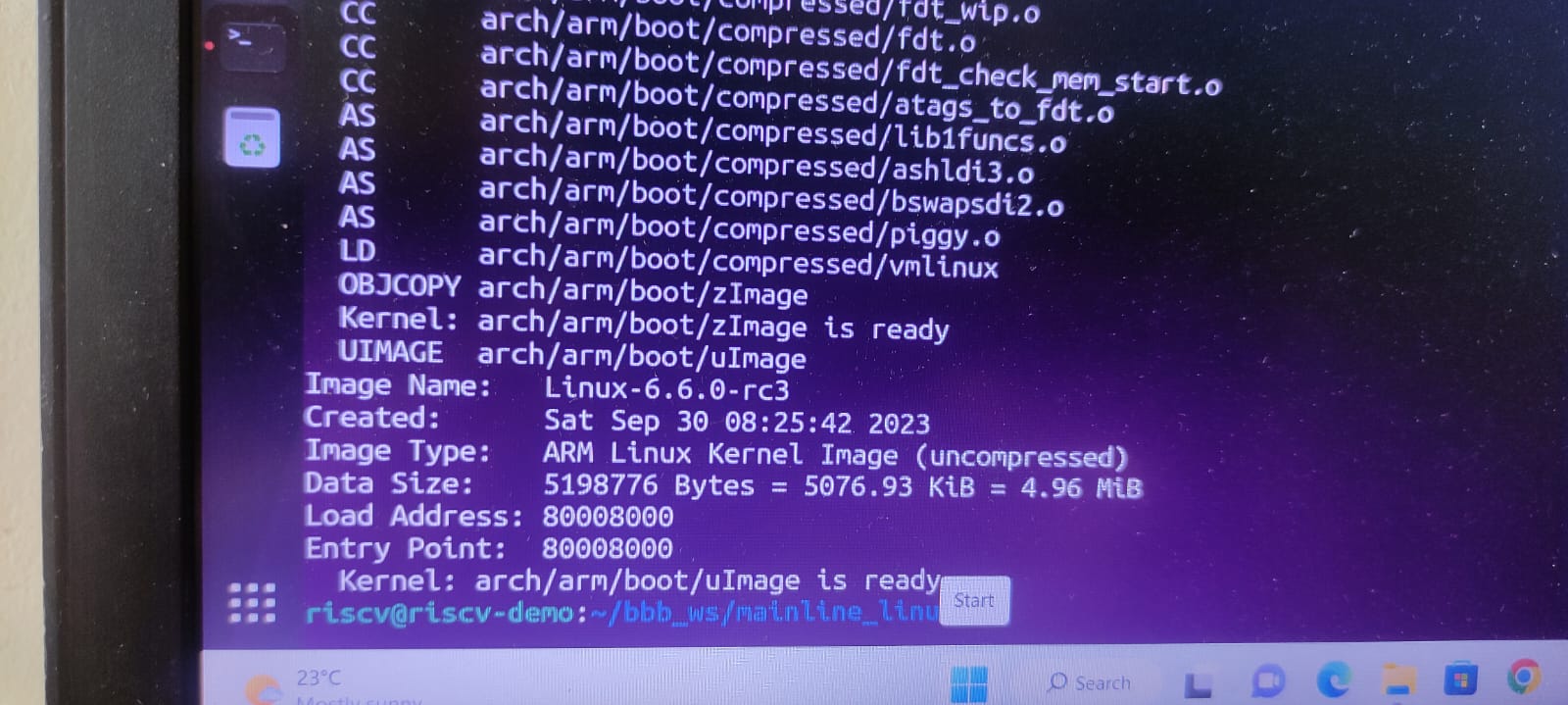

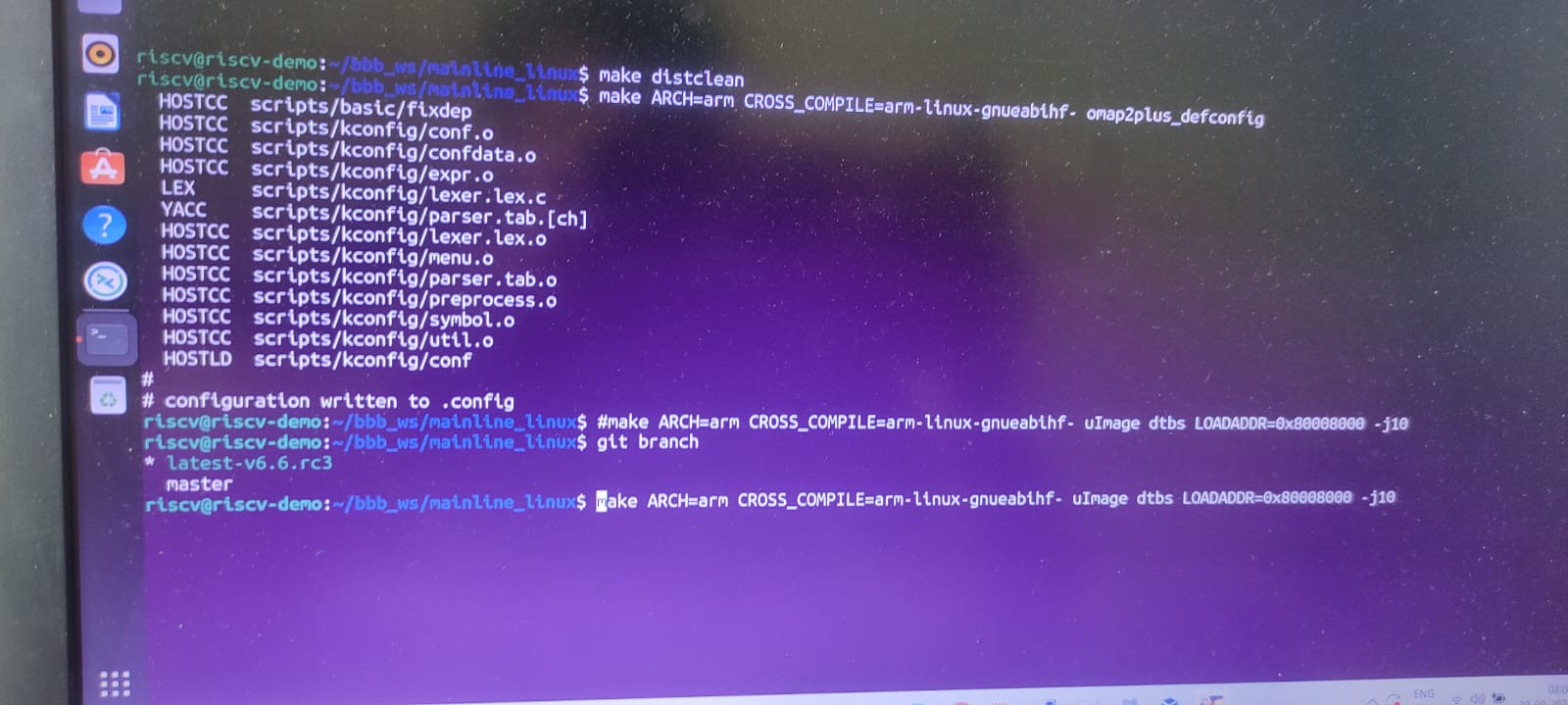

what defconfig did you use as a base for 6.5.0-rc1
I am not restricted to any branch. I have this kernel already in my system so I build that.
Now I freshly cloned linux kernel source from Github.
GitHub - torvalds/linux: Linux kernel source tree
Again build the kernel successfully with omap2plus_defconfig as shown in picture.
But unfortunately, Result is same. You can see in the log.
