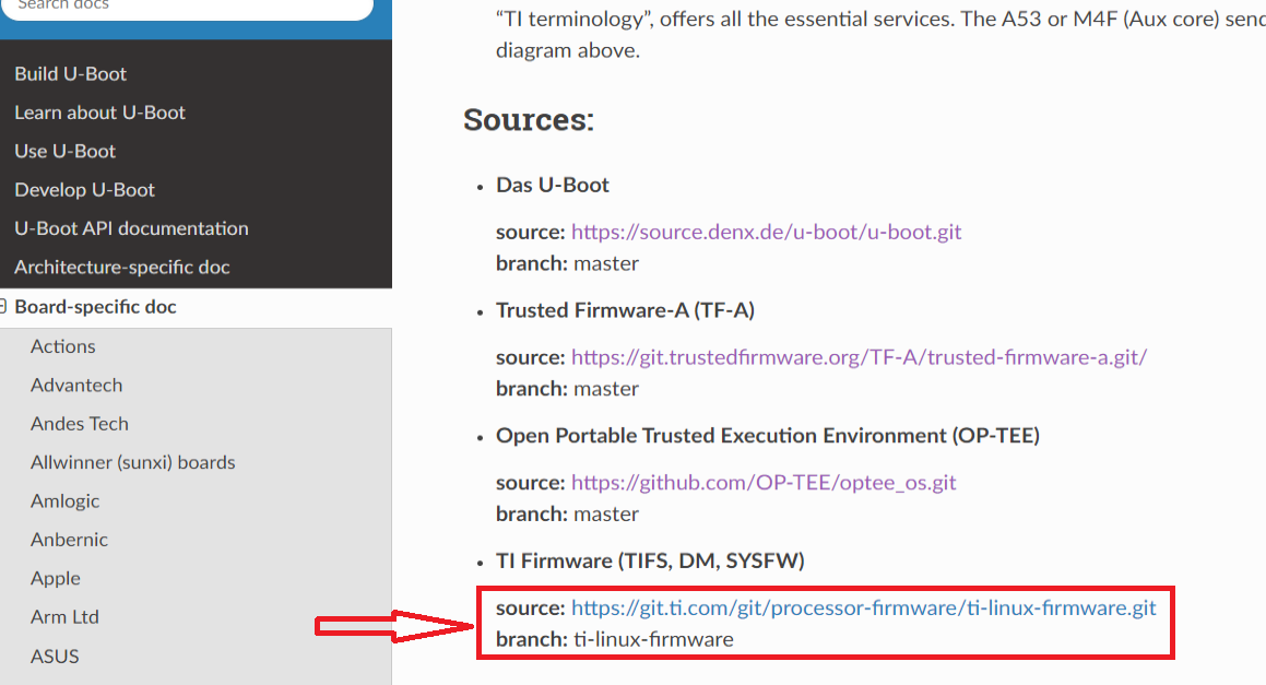

Dear Experts,
As mentioned in the above topic and in the following link AM62x Beagleboard.org Beagleplay — Das U-Boot unknown version documentation I tried to clone the repo, but it’s showing a “not found” page. Please suggest the proper link for cloning the source of U-Boot.
and Please find the attached file for reference as well.

I access that thru cgit: https://git.ti.com/cgit/processor-firmware/ti-linux-firmware/
on the bottom there are 4 ways to clone the repo…
https://git.ti.com/git/processor-firmware/ti-linux-firmware.git
git://git.ti.com/processor-firmware/ti-linux-firmware.git
http://git.ti.com/git/processor-firmware/ti-linux-firmware.git
Thank you, Robert, for your information.
Regarding the repository at https://git.ti.com/cgit/processor-firmware/ti-linux-firmware/, which one of the following branches should I use?
**Branch**
- ti-linux-firmware
- ti-linux-firmware-next
- main
- ti-firmware-next
- master
- ti-linux-firmware-4.1.y
Thanks and Regards,
Ravikumar
Dear Robert,
Thank you for recommending the ti-firmware solution; it helped resolve the issue. However, after following the boot flow steps outlined in the documentation (ref: AM62x Beagleboard.org Beagleplay — Das U-Boot unknown version documentation), and creating the images (tiboot3.bin, tispl.bin, and u-boot.img) for the BeaglePlay board, I encountered a problem as the images are not booting.
