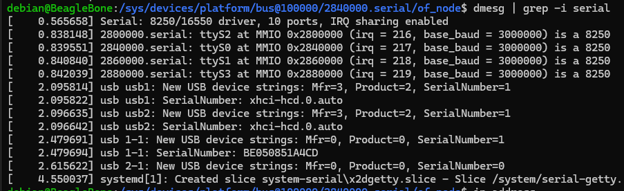

Running dmesg | grep -i serial I was able to figure out the default file handles for UART. I tested, the handles are working.
So, 2860000.serial is UART6. For my case here, as seen in the screenshot, its handle is /dev/ttyS1.
These handles can change, in-fact, I believe they may even change between reboots. With this, it is time to figure out some udev rule magic…still trying to understand this stuff.
