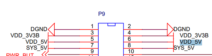

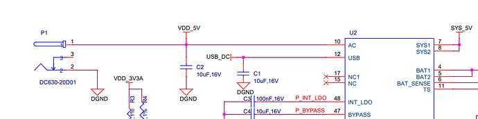

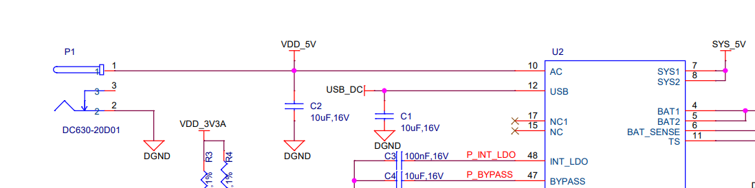

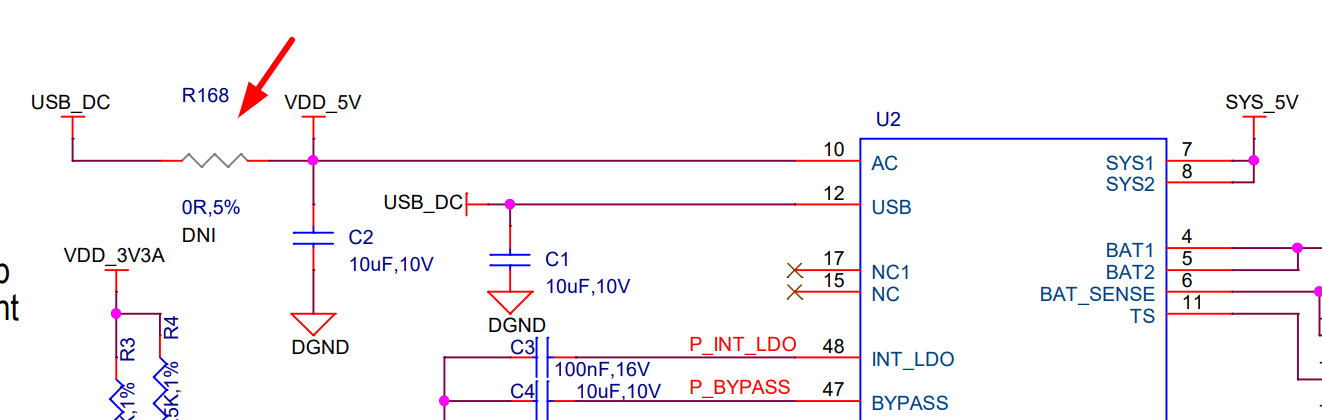

I am facing problems connecting these modules together. When connecting these mentioned boards the BP-CC3301 plug-in WiFi module is not powered up by the BBG. I did solve this by connecting the mentioned WiFi module to a separate power supply, by doing this I also removed J6 and J9 jumper caps. This ensures that the mentioned WiFi module is powered on, however, through UART it is seen that the device keeps reloading in the bootloader mode.
