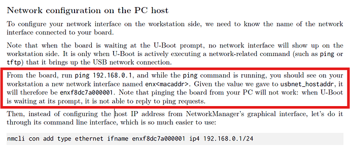

Then, I sent ping 192.168.0.1 as it suggested to set up networking on host side.
However, this ping didn’t work and gave the following error:

Could this be because I’m using VMWare instead of actual Ubuntu machine? Because in “Removeable device”, there is nothing that indicates the BBB board after booting to u-boot prompt.
USB is enabled in u-boot’s menuconfig by default. I have also changed USB controller compatibility in VMWare to 2.0 to make it compatible with musb-hdrc but still no difference. I’m still suspecting this is due to VMWare and I’m trying to do this again on a native Ubuntu machine.
