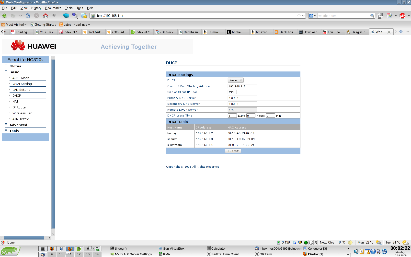

Some stuff from dmesg - looks like it's disconnecting for some reason
Attached is a snapshot of the router, the beagleboard does not show up
there with the rest of the boxes.
Regards
Sid.

UK channnel 1, 3 other Linux boxes the same and working. I attached a
snapshot of the router showing the 3 boxes with IP addresses assigned to
one of my recent postings
Regards
Sid.

root@beagleboard:~# ifup wlan0
WPA: Configuring Interface
[46481.988098] rt73usb 1-2.3:1.0: firmware: requesting rt73.bin
[46482.152130] ADDRCONF(NETDEV_UP): wlan0: link is not ready
[46484.664337] ADDRCONF(NETDEV_UP): wlan0: link is not ready
udhcpc (v1.13.2) started
run-parts: /etc/udhcpc.d/00avahi-autoipd exited with code 1
Sending discover...
Sending discover...
Sending discover...
No lease, failing
root@beagleboard:~#
Regards
Sid.
