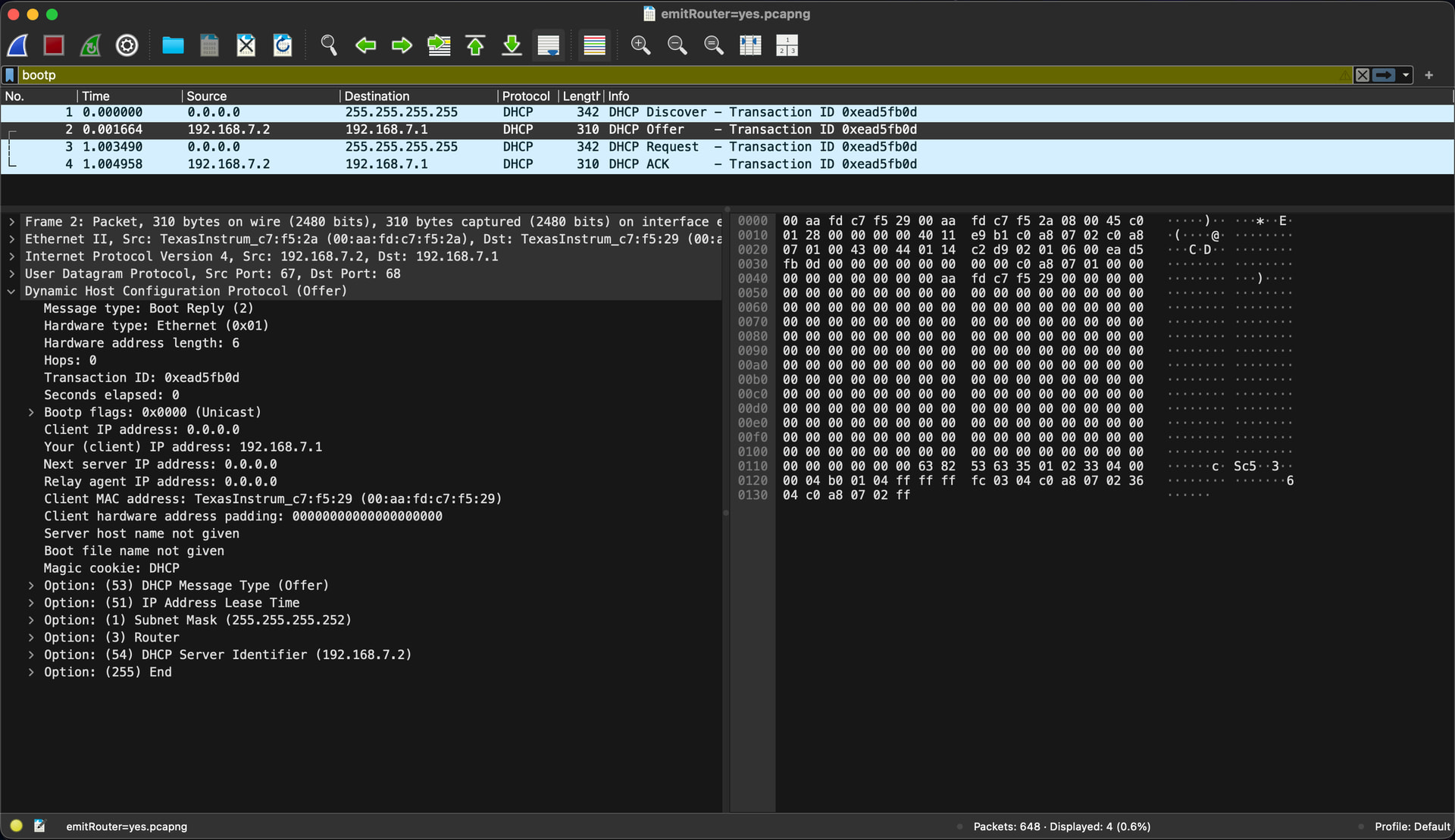

With the board attached over USB, the host loses all internet connectivity.
The host’s IPv4 default route is replaced by 192.168.7.2, and the existing route via the Wi-Fi gateway is demoted to interface-scoped. Multicast and broadcast routes move to the USB interface as well. Since the board has no upstream, all internet-bound traffic is blackholed.
Unplugging the board restores connectivity immediately. Reproducible in both directions.

/etc/systemd/network/usb0.network (from bb-usb-gadgets) contains EmitRouter=yes, so the board’s DHCP Offer includes Option 3 (Router) pointing at itself.
This setting was present before the 07-22 fix, but had no effect because DHCPServer=true was missing and the server never ran. Enabling the server made it live.

EmitRouter=yes
DHCP Offer as shipped, EmitRouter=yes, 310 bytes:
Option: (53) DHCP Message Type (Offer)
Option: (51) IP Address Lease Time
Option: (1)  Subnet Mask (255.255.255.252)
Option: (3)  Router
Option: (54) DHCP Server Identifier (192.168.7.2)
Option: (255) End
EmitRouter=no
Same exchange with EmitRouter=no, 304 bytes:
Option: (255) End

Proposed fix
EmitRouter=no in the [DHCPServer] section of usb0.network.
Tested: Option 3 disappears from the Offer, the host no longer installs a default route via the board, and the board remains fully reachable at 192.168.7.2 over ICMP and SSH. No other DHCP options are affected.

Just pinging @RobertCNelson can you add:
[DHCPServer]
EmitDNS=false
EmitNTP=false
EmitSIP=false
EmitRouter=false
To the usb0.network - as it should stop the default router being changed by the beagle family.
Edit: and just check @RobertCNelson has this already in his usb0.network file. So if your /etc/systemd/network has a file like this, which stops the beagle emitting things like a default router, ntp, dns, etc. But it should keep the local address directed towards the beagle.
I think the EmitRouter=false part is the important bit here. The BeagleBone still needs its own gateway for routing, but theres no reason for that gateway to be advertised to the host through DHCP when the USB connection isn’t providing upstream internet access. The route output you posted makes the behaviour pretty clear: the host keeps the Wi-Fi default route while using the USB interface only for the 192.168.7.0/30 local network. That seems like the cleaner setup for the gadget interface. If the default route is currently being added by the DHCP server on usb0, fixing the networkd configuration so it only advertises the local network should avoid the host suddenly preferring the USB gadget interface. That would also make the setup behave more predictably on systems like macOS where the USB Ethernet interface may get a higher priority than Wi-Fi.
