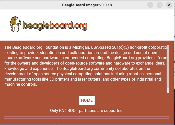

v0.0.15: bb-imager failure
running bb-imager-gui_0.0.15_x86_64.AppImage
with or without sudo, i get, what’s missing?

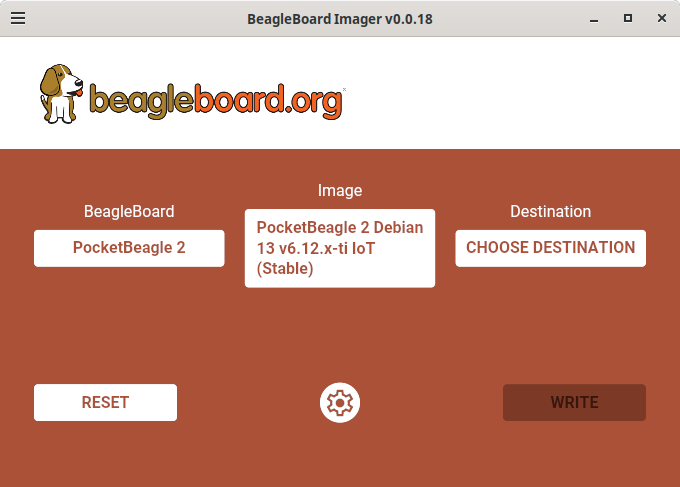

Please retest with v0.0.18 which got released over the weekend: Releases · beagleboard/bb-imager-rs · GitHub
and please share your “Board” and then “image” selection so i can smoke test it locally..

image was PB2 IOT, think it had a date of 12/2025

still issues, the sdcard most likely had an rpi image on it. do i need to reformat the sdcard before using bb-imager ??

2026-01-13T13:17:04.700626Z ERROR bb_imager_gui: Flashing failed with error: InvalidBootPartition

latest release still fails

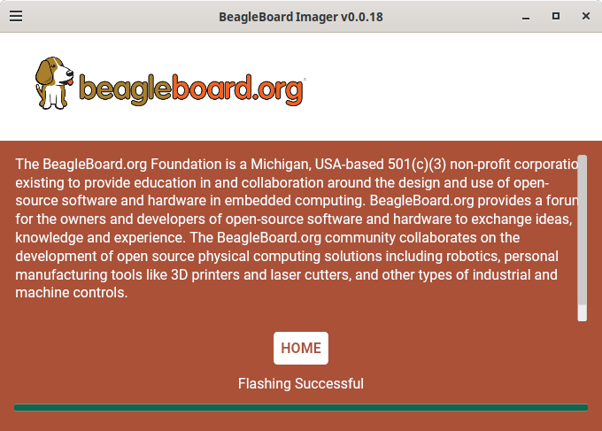

So, I tested flashing on ubuntu 22.04 vm just now, and it seems to work fine.
Can you maybe try flashing without any customization?

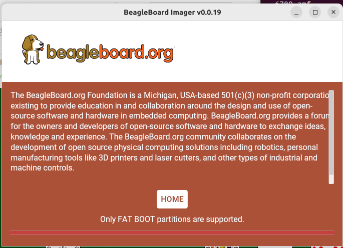

same issue
Can you try flashing an image with rpi-imager?
same issue
