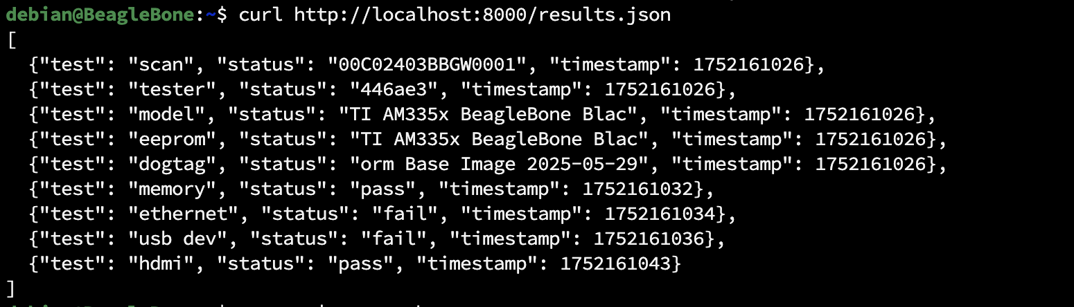

Added functionality to serialize test results from beagle-tester into structured JSON format at /tmp/results.json for use by web server.
Developed a standalone HTTP server using Mongoose to serve test results and frontend over port 8000.
Integrated asynchronous launch of the web server using fork() and execl() immediately after test completion.
Refactored the Makefile to build and install the web server and UI assets independently from the main beagle-tester binary for cleaner separation.
Implemented logic to avoid duplicate or defunct server processes using pkill, and verified cleanup behavior under repeated test cycles.
Successfully tested the entire flow by triggering tests, launching the server, and validating live access to /results.json via browser and curl.

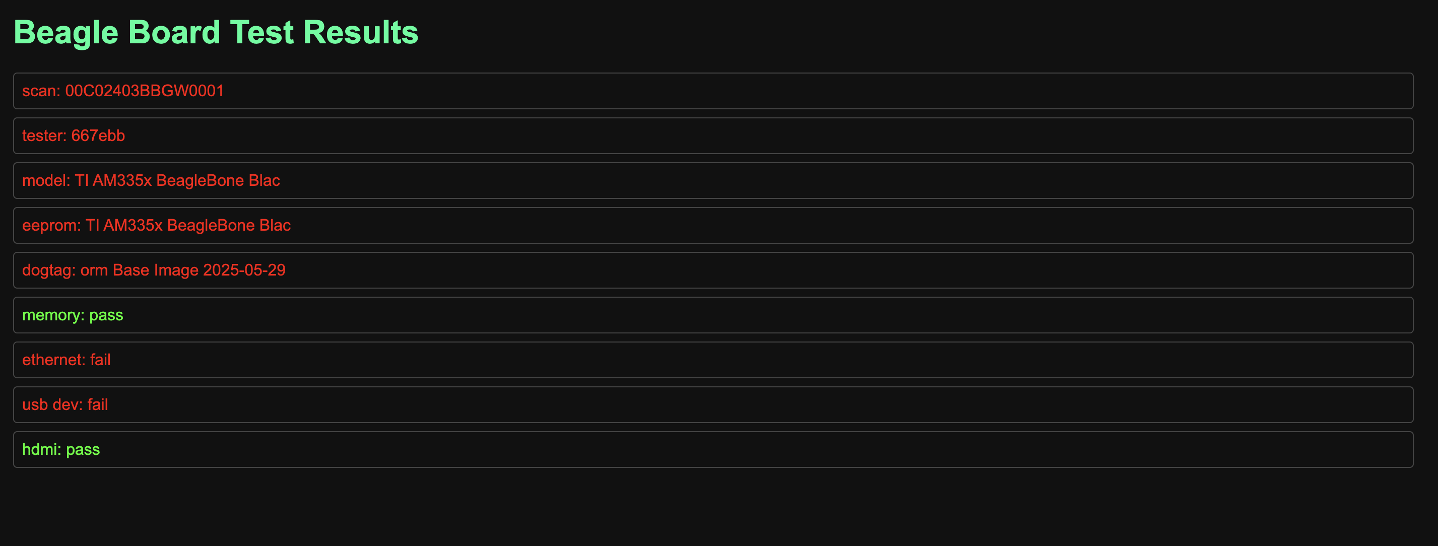

Plans for the Week
Plan to refine the output (As you can see int the snapshot, it is storing everything printed with beagle_notice. I plan to separate and refine this) and complete the frontend for it.
I have attached pictures of it.

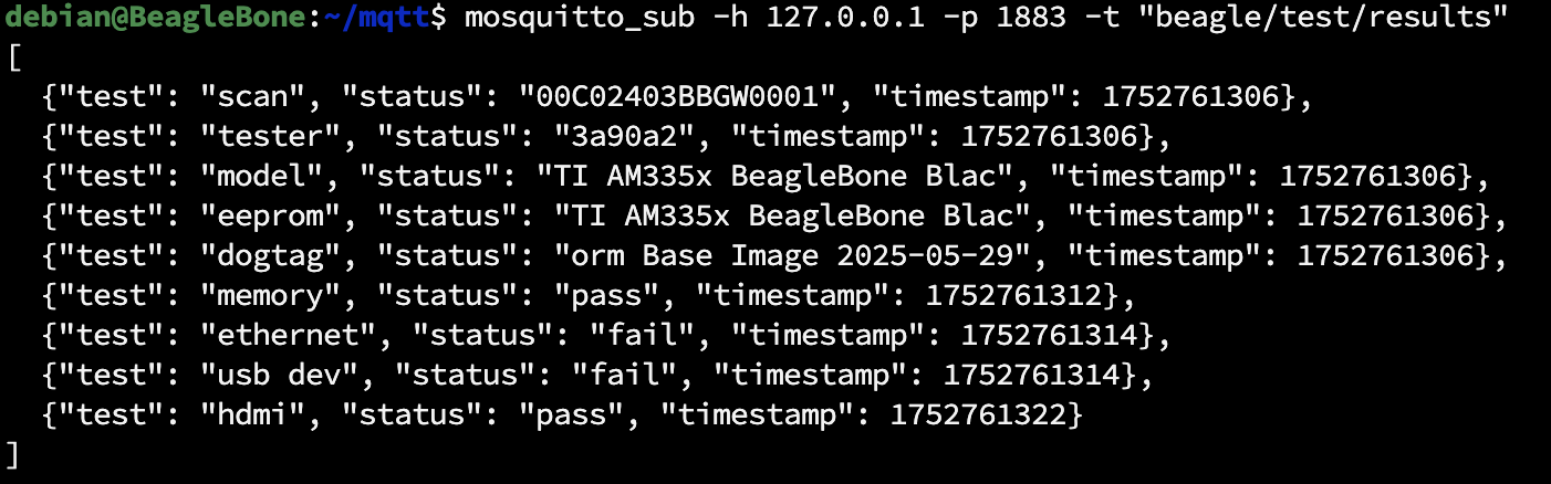

Added support for MQTT publishing of test results to a configurable broker using a background process (mqtt_publisher) triggered after test execution.

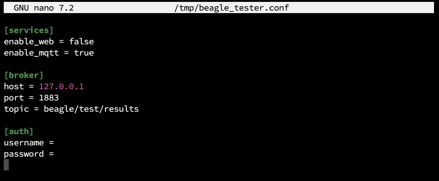

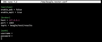

Created a flexible configuration system for MQTT using INI-style files with support for broker credentials, topic, and enable flags under [services], [broker], and [auth] sections.
Configuration is fully externalized, allowing end users to customize broker settings, credentials, and toggles without modifying the source code. The installation installs an empty template by default.
The full test flow, including MQTT publishing, can be triggered via command-line scan arguments passed to beagle-tester, making it suitable for both automated and interactive use.
Successfully tested MQTT flow by running a local Mosquitto broker and verifying message delivery over the network via mosquitto_sub. Snapshot attached.
Also finished with the frontend of webserver. Snapshot below
