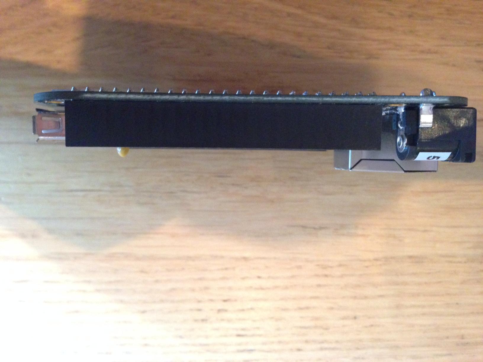

It just means that capes will need a higher clearance for just that one component (as seen from the profile pic I attached). I'd remove it, but wouldn't want to void the warranty - at least not yet.
That is not generally not an issue based on using standard available connectors, If you decide to cut one down, it may be a little issue. You ca always just press it down like I just did between the USB and the expansion header.
