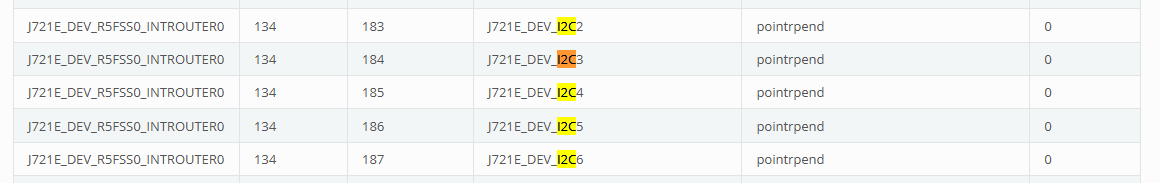

Zephyr I2C
With Zephyr I see that the IR IDs for I2C2 - 6 from the zephyr device tree line up with the TISCI table linked above. Not sure what is up with I2C0 and I2C1, little schizoid, but whatever, mainly I see things lining up like how I would expect.
Zephyr DT: zephyr/dts/arm/ti/j721e_main_r5.dtsi at be667e782692bebf5f7f72b80c77b7a4f3c38a0b · malto101/zephyr · GitHub
Screenshot from TISCI table:

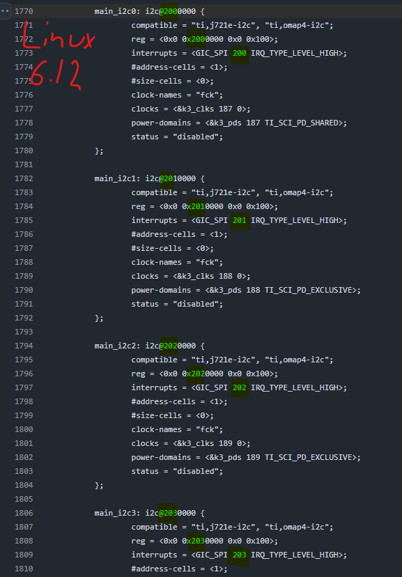

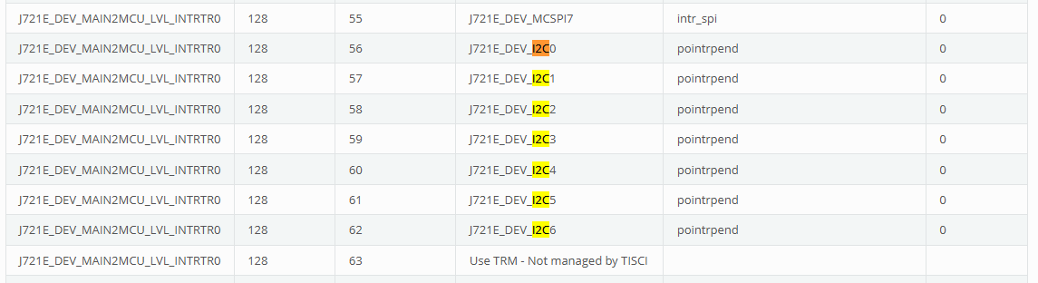

Linux I2C
The Linux DT does not lineup with the TISCI tables…
Linux DT: BeagleBoard-DeviceTrees/src/arm64/ti/k3-j721e-main.dtsi at dd3342c2a3e6df6ee02eaa7083d3ad66bd3bfe82 · beagleboard/BeagleBoard-DeviceTrees · GitHub
Screenshot from TISCI table (DOES NOT MATCH WITH LINUX DT):

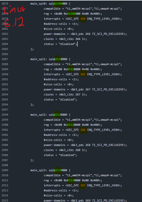

Something odd I notice…the interrupt ID’s for I2C on Linux seem be simply the first 3 digits from the I2C base addresses…WHAT…ok
I do not believe taking the 3 high digits from the base address is a standard. Look at MCSPI. As far as I can tell, random numbers grabbed from a bowl of dice. These number do not line up with anything from what I can tell. Not the TISCI tables, not the high 3 base address digits.
What is going on here? Why do all these number seem so random. Are there several unpublished random standards that people are going by? Could I simply change these numbers as I please?
