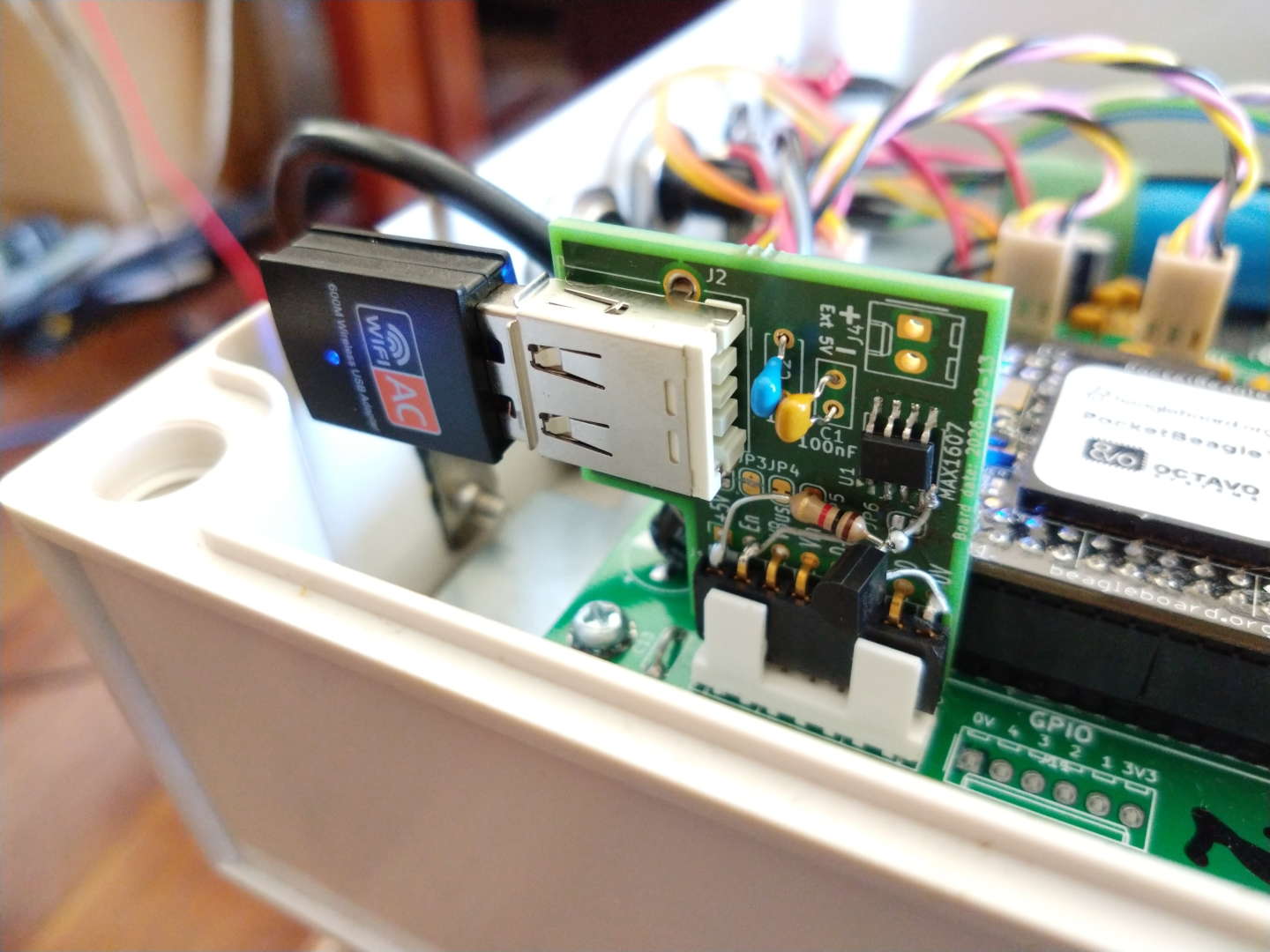

I’m busy revamping some data reporting devices that we’ve built back in 2018 for reporting RFID tag reads over AX.25 packet radio, adding WiFi dongles to them and setting them up to host a WiFi network so a separate device (a Raspberry Pi Pico2 W based sign) can connect over WiFi. The devices are built on original PocketBeagles (AM3358-based). This is being done for a not-for-profit emergency comms group with a skint budget, buying PocketBeagle 2s is not a practical option.
The image is a Debian 11 image that I’ve dist-upgraded to Debian 13. I will try a stock Debian 13 image if I can find one, but for now I just updated the existing install so that I maintained the existing board configuration.
The plan is for the PocketBeagle to host its own wireless network, so the WiFi interface needs to operate in AP mode. I’ve made a break-out board that brings the USB interface on the PocketBeagle header out to a USB-A socket, and into this I’ve plugged a generic USB WiFi dongle based on the rtl8821cu chipset.
Aside from some fun-and-games with USB_EN being active-high whilst the USB high-side power switch I used being active-low (needing a MOSFET/resistor inverter to be dead-bugged onto the PCB), I have the USB dongle working as a client. The trouble is making it work in AP mode (allegedly supported by the chipset).
