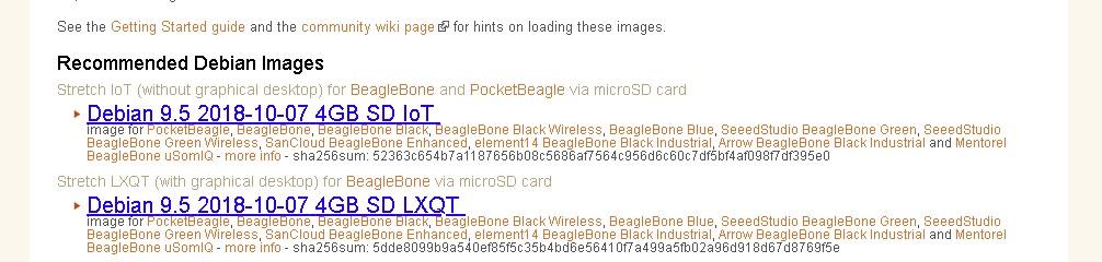

P.S. Erase your eMMC after booting into your SD Card version of Debian on your BBB. Also, if you would like, use the bbb.io/latest-images updated image to flash to the eMMC and to the SD Card. I am pretty sure this will ensure you to have full functionality of the BBB and the related peripherals.

Use one of these two images from https://beagleboard.org/latest-images.
