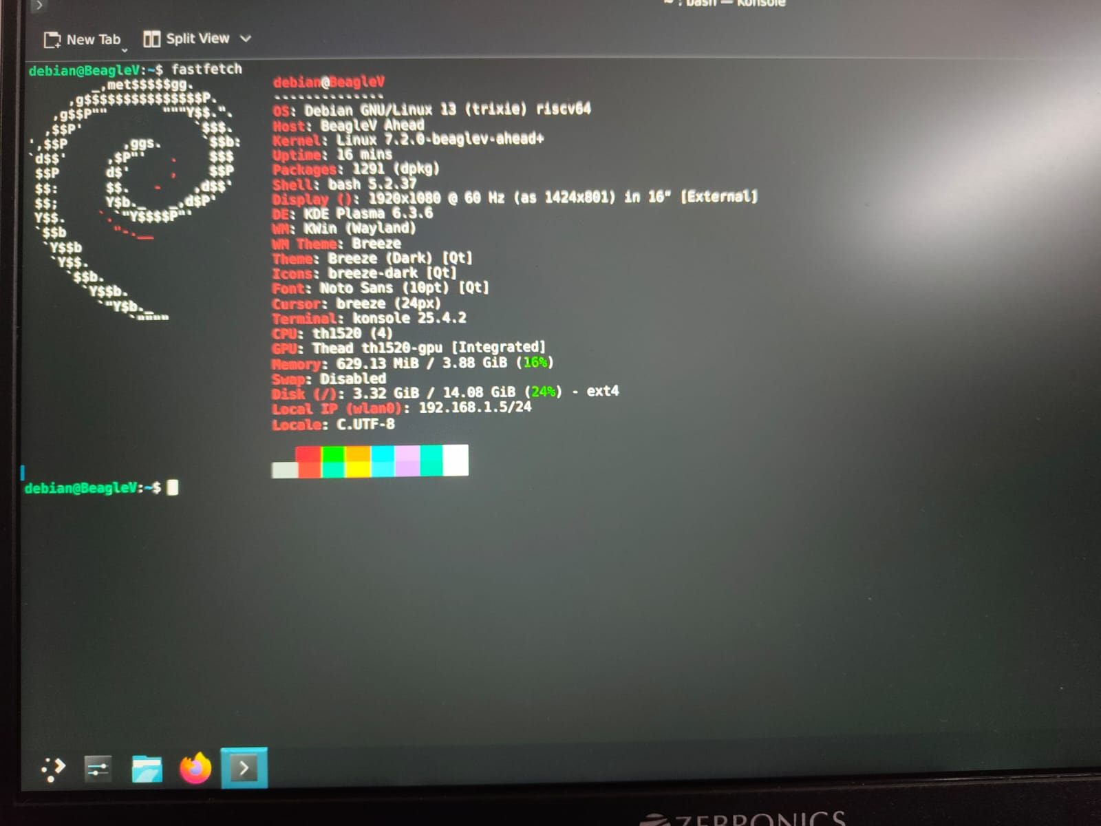

After weeks of work I finally have a working image for BeagleV Ahead with the following specs:
  • A very custom patched kernel 7.2.0 for the board.
  • Working USB
  • Working Wifi
  • Working Bluetooth? (Untested)
  • Working all 4 cpu cores
  • Working Ethernet
  • Working HDMI out
  • Working GPIOs
  • Working GPU* (Both kernel patches and a custom Mesa driver)
  • and more…
So, the GPU is currently very experimental. It does expose VK 1.3, not all extensions obviously and does support ogl 3 through zink but the GPU cannot provide hardware acceleration just yet.
I am working on various patches rn and will release a debian based distro for the board at some point.
All general risc packages work just fine btw.
(Yes, usable KDE plasma)
Why? Well … just cause mainline patches are taking too long for my liking and I’d actually like to use the board in some useful way.
