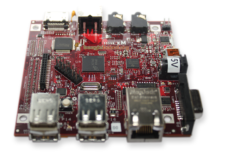

I have very old , may be 5-6 years Beaglebaord -xm target. Can we compile the Yocto porject on the target ? May be latest or old version. Please suggest . or I need to buy a latest Beagleback board.

BeagleBoard-xM launched in 2010.
Not sure how to find all the right bits for Yocto. Maybe we should reach out to some specific people who used it back then?

I don’t currently have that board and have never touched one, it is assumed this is correct since it is the official Ti bsp.
Soc for Beagleboard-xm is
AM37x 1GHz ARM Cortex-A8 compatible

Thanks. Right it is back then around 2010. May I know any required contact person. I checked in ChatGPT it say can work based upon the revision A/B/C/D.
X15 != xM
X15 = AM5729
xM = OMAP3430/DM3730
