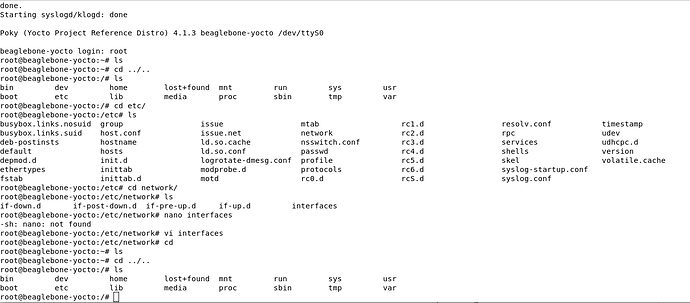

Okay…I got it,
@softorchestra , here is a screenshot of my build on the BBB so far, i.e. no apt, only vi, and I cannot ssh just yet.
P.S. I will keep trying.
Seth,
AWESOME! You’re on your way!
Use “ip addr” to look at the network interfaces:
