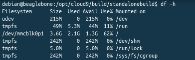

when I run df -h, I get :

I run df -h after :
cd /opt/scripts/tools/
git pull || true
sudo ./grow_partition.sh
sudo reboot
Look again:
“sudo reboot”
It’s still the same issue.
Please share this:
cat /var/log/resize.log
That shows us, resize2fs ran and the disk is already maxed out…
