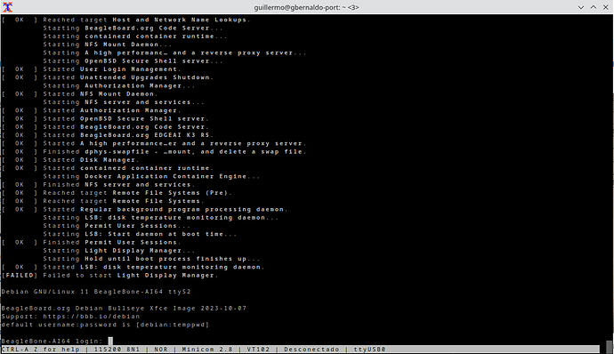

But after this I cannot do anything, I always get the next errors:
debian@beagle:~$ sudo apt update
Get:1 http://deb.debian.org/debian bookworm InRelease [151 kB]
Get:2 http://deb.debian.org/debian bookworm-updates InRelease [55.4 kB]
Get:3 http://security.debian.org/debian-security bookworm-security InRelease [48.0 kB]
Get:6 http://deb.debian.org/debian bookworm/main arm64 Packages [8688 kB]
Get:7 https://packages.mozilla.org/apt mozilla InRelease [1528 B]
Get:4 https://repos.rcn-ee.com/debian-arm64 bookworm InRelease [3074 B]
Get:8 http://security.debian.org/debian-security bookworm-security/main arm64 Packages [166 kB]
Ign:9 http://deb.debian.org/debian bookworm/main arm64 DEP-11 Metadata
Ign:10 http://deb.debian.org/debian bookworm/main arm64 Contents (deb)
Ign:11 http://deb.debian.org/debian bookworm/main all Contents (deb)
Ign:12 http://deb.debian.org/debian bookworm/contrib arm64 Packages
Ign:13 http://deb.debian.org/debian bookworm/contrib arm64 DEP-11 Metadata
Ign:14 http://deb.debian.org/debian bookworm/contrib arm64 Contents (deb)
Ign:15 http://deb.debian.org/debian bookworm/contrib all Contents (deb)
Err:7 https://packages.mozilla.org/apt mozilla InRelease
  Unknown error executing apt-key
Err:4 https://repos.rcn-ee.com/debian-arm64 bookworm InRelease
  Couldn't create temporary file /tmp/apt.conf.Uy2pdK for passing config to apt-key
Ign:16 http://deb.debian.org/debian bookworm/non-free arm64 Packages
Ign:17 http://deb.debian.org/debian bookworm/non-free arm64 DEP-11 Metadata
Ign:18 http://deb.debian.org/debian bookworm/non-free arm64 Contents (deb)
Ign:19 http://deb.debian.org/debian bookworm/non-free all Contents (deb)
Ign:20 http://deb.debian.org/debian bookworm/non-free-firmware arm64 Packages
Ign:21 http://deb.debian.org/debian bookworm/non-free-firmware arm64 DEP-11 Metadata
Ign:22 http://deb.debian.org/debian bookworm/non-free-firmware all Contents (deb)
Ign:23 http://deb.debian.org/debian bookworm/non-free-firmware arm64 Contents (deb)
Ign:24 http://deb.debian.org/debian bookworm-updates/main arm64 Packages
Ign:25 http://deb.debian.org/debian bookworm-updates/main arm64 Contents (deb)
Ign:26 http://deb.debian.org/debian bookworm-updates/main all Contents (deb)
Ign:27 http://deb.debian.org/debian bookworm-updates/contrib arm64 Packages
Ign:28 http://deb.debian.org/debian bookworm-updates/contrib arm64 Contents (deb)
Ign:29 http://deb.debian.org/debian bookworm-updates/non-free arm64 Packages
Ign:30 http://deb.debian.org/debian bookworm-updates/non-free arm64 Contents (deb)
Ign:31 http://deb.debian.org/debian bookworm-updates/non-free-firmware arm64 Packages
Ign:32 http://deb.debian.org/debian bookworm-updates/non-free-firmware arm64 Contents (deb)
Ign:5 https://debian.beagle.cc/arm64 bookworm InRelease
Ign:33 https://debian.beagle.cc/arm64 bookworm Release
Err:10 http://deb.debian.org/debian bookworm/main arm64 Contents (deb)
  Could not open file /var/lib/apt/lists/partial/deb.debian.org_debian_dists_bookworm_main_Contents-arm64.gz - open (30: Read-only file system) [IP: 151.101.134.132 80]
Err:24 http://deb.debian.org/debian bookworm-updates/main arm64 Packages
  Could not open file /var/lib/apt/lists/partial/deb.debian.org_debian_dists_bookworm-updates_main_binary-arm64_Packages.xz - open (30: Read-only file system) [IP: 151.101.134.132 80]

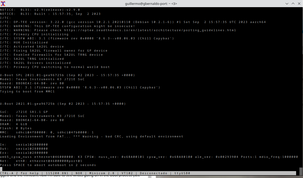

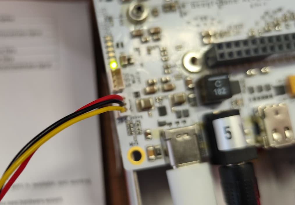

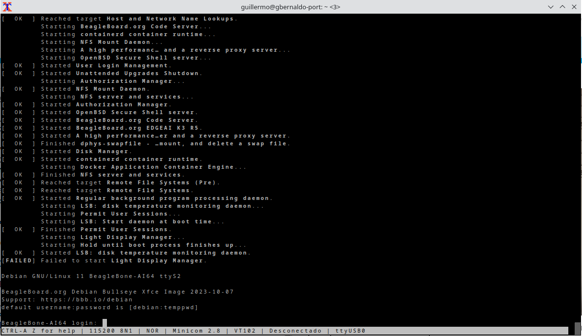

Meanwhile, the wires arrived, and right now I have the wires plugged into the hardware.
The USB wire I’m using is this: Amazon.es
And the connection between my pc and the ai64 is shown in the next pictures. The wires in the ai64 side are connected to the J3 connector.
With the wires plugged and the minicom (minicom -D /dev/ttyUSB0 -b 115200), now I’m able to see whats going on in the boot process (see next pictures)
The thing is now I can see the uboot and the boot process of the ai64 without any problem, but, when I press any key in the uboot process or in the login process the ai64 does not respond to the key presses. It’s like the tx pin (in the USB side) is not working correctly.
Does anyone has idea about this problem and knows how to solve it?
Thank you so much in advance!
ok first thing is check you don’t have flow control turned on
In minicom do ctr-a o and select Serial port setup. Make sure hardware and software flow control are turned off.
If that doesn’t work and you have a DVM I would suggest checking continuity of the wires. Fortunately the uart connectors are not surface mount and you can get to the pins under the pcb
could be you have a bad crimp/connection somewhere.
Thanks @benedict.hewson again!
That was the problem, The setting HW Flow Control was enabled.
Thanks again men!
