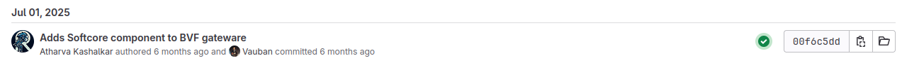

Yikes! Yes, even your “newest” Gateware is from Jul 01, 2025; it’s pretty old.
We’ll have to ask @RobertCNelson why that is…
While we’re waiting, could you please go here and grab the latest build?
You can extract the Gateware in your homedir; does not need to be where change-gateware.sh is.
Keep the Linux image stable. I’d like to know if that fixes your issue or we need
to start troubleshooting the 6.6 image.
Using the latest build from the repo you mentioned worked @lranders !
I fetched the latest build on main (commit 4e16f48a) and used those bitstreams with the change-gateware.sh script as so:
sudo /usr/share/beagleboard/gateware/change-gateware.sh bitstreams_4e16f48a/default/
(Still on this BeagleV-Fire Ubuntu 24.04 2025-07-21 IoT (v6.6.x) after running apt update + upgrade).
Really weird that I cannot manage to fetch the newest version using apt, though.
Truth be told, I always do as you just did, so I haven’t been keeping tabs on the .debs.
I’m sure @RobertCNelson will be able to “fill in the blanks”, so to speak.
